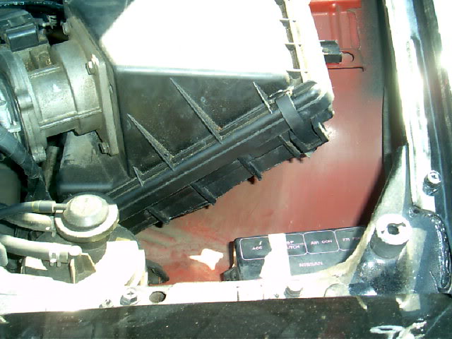

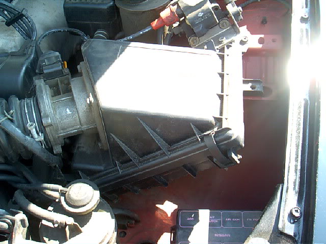

4. And finally you can go the ghetto way and make the intake out of your stock airbox
Heres the link with instructions and pics...
-As you can see, you will need to plug up the areas where the two hoses used to be, find a way to re-route the hose, or use a small filter (breather filter). The last pic has both filters in blue.

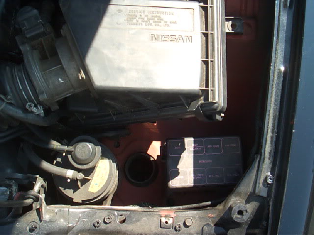

ok ok i got a question adding to this post even though the last post was made in 05. why in tha He77 would you want to cut the air box and suck in hot 300* engine bay heat. why not take a peice of 3" pvc cut a hole in the side of the air box and the wheel well, were you dont get water, link the 2 with the 3" pvc, and you'll still get good sound and power even though it may only be 2-5 hp & tq like an intake. he77 lets add to it for 8 bucks go buy a can of adhesion promoter and some ceramic paint the color of your choice and ceramicoat you intake an all your intake componets keeping them cooler and geiving you lik 1-2 hp & tq.
go to the ford escort forums those guys are desprit for power and will do anything for it, tons of great ideas there.
well we are talking about away from the engine. the pvc should be ok. i did this on my little ford escort when i had it, its engine bay was way hoter than this 240's engine bay, your not touching the engine your just in the radiated heat so it should be ok.
