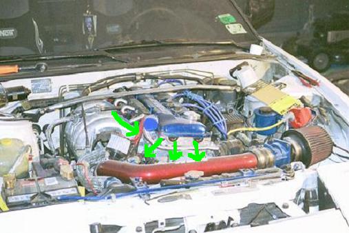

On the 95 240 the power transister is on the top or the side of the MAF.
look at the pic. It is the main wiring harness that goes across the radiator and the fan shroud, I marked it in green.
