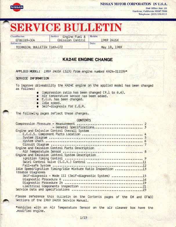

i saw a cpoy of a TSB where nissan lowered the CR of the sohc for driveability issues
but i also saw conclicting reports of the KA24DE engines CR between the S13 and S14

http://socal**********/faq/images/92c.jpg <- here's the link guys..not sure how reliable it is but it says nissan corp so it should be a pretty good source...wat's fsm? thats who they said did the stats..maybe different years had different c/r?

FSM = factory service manual
c/r = compression ratio
