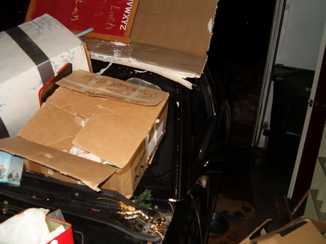

heres a pic of the roof falling onto the car lol
damn that must have sucked to see that in the garage.
