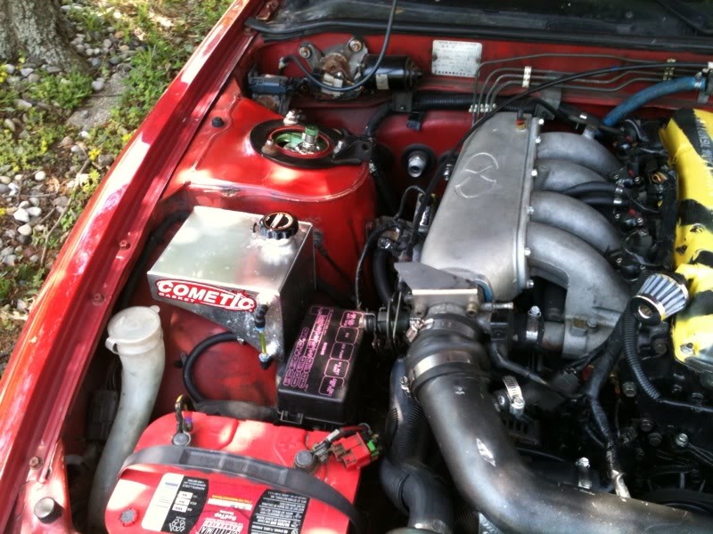

well i got mb battle wheel which r pretty danm light for 17 uum...im usin obx headers,now what is the tb coolant condenser?any pics of itt so i kno what im lookin for??the thermo intake mani gasket comes with the xcessive intake mani..valve springs / retainers i do need 2 get though..i was thinkin i might get bigger valves but the stock ones r already a nice size on the ka..do anyone know if the 95-98 kade head has bigger valves or not?some where i remember reading that 95-98 head flowed better,can any one conform this?
Old May 29, 2010 | 05:22 PM
i would have gone with ITB's instead of that manifold.
NA SR's make good power i done see why a KA cant. and im not talking about VVL im talking about regular old rwd NA SR's they can get into the 200+ whp easy.
hell i got a buddy with a sentra with a Built NA VVL SR making 364whp
