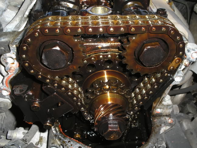

This is an overview of my chain system... Thought my upper tensioner was bad... its not

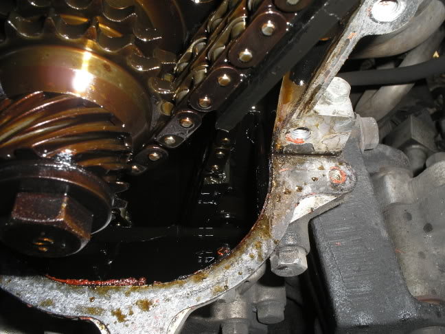

So i started looking at the guides, and found this: Looks snapped off to me. Does anyone have a pic of what it normally looks like?
And a closer view:
and i think it was caused by a bad lower tensioner... look right to you? i dont know what it should look like
What do you guys think? DO i need that guide down there?

Looks like its Toast. Happened to me recently. See if any SR guys have a KA around it's cheaper than a new timing chain setup.

Oh I didn't know, sounds like the Motor is Money otherwise! It looks like Metal Shavings are getting in Oil by the Chainsaw effect. You don't want any shavings blocking any Oil passages.

oil is fine... i changed it the day after it started rattling, thinking the oil wasnt allowing enough pressure to the tensioner or something...didnt look letallic... gotta check it to make sure again... well at least i got a chance to put some rtv under my valve cover to seal up the slight oil seepage from having 2 holes stripped.
