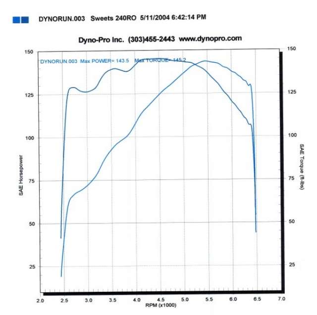

Well it's just not about breathing, it is also about scavaging and backpressure. If you haven't noticed the stock Nissan headers suck. There main purpose and design was to increase maximum back pressure, in order for the EGR valve to do it's job by consuming hot exhaust gas ( which takes up space in the intake manifold and decreasing the amount of air (positive intake charge) that could of been consumed through each cylinder. Most USDM's were designed this way to increase gas mileage, by shrinking the pulse width (or rate of injection). This is also used to use proper exhaust gas reciculation, (which of course we use as a benefit for our USDM's to lower NOX emissions. (which in my mind is retarded the KA runs at under a 9.6:1 compression which I don't believe would get NOX levels high enough not to pass, unless of course the pulse width was to short creating a really lean mix, which would raise chamber tempratures). That inevetably wouldn't happen though due to the fact that Nissan tunes a 7% fuel richner at lower throttle, (which means that fuel has infact already been increased to the intake charge, more fuel than air in the A/F ratio). This kind of serves as a oximoron and kills performance, and at the same time isn't as fuel conservative as once thought with the old methods of tuning back in the late 80's and early 90's.
Now there is also a problem with scavaging on the stock headers, scavaging is what allows the exhaust pulses to run back up to the cylinder and possible double or triple the load on the positive intake charge(maybe in small doses though since the cams don't do to much overlap), (again taking space that clean air could of used and been consumed by the engine). Many flaws by design created the KA to become a very anemic engine, and I believe that the main focus is infact to the exhaust system and the manner in which it recirculates hot exhaust gasses.
Problem one with stock header, runners are to short allowing pulses to run back up the cylinder at earlier rates, they were also made to increase back pressure, shorter runners make it easier for the EGR to collect exhaust gasses(obviously bad for a performance enhancer). ( I always screw up with the differences between back pressure and scavaging so if I didn't use correct terms some one please correct me.)
Second problem is the small exhaust system at 1.75", exhaust is a waste or biproduct, the more you slow down the pulse the harder it is for the engine to function. Kind of like when some one takes a constopated shiat and is stuck on the toilet for an hour. (It slows everything down), hopefully an easy analogy to understand.
Now look at the stock ecu tune, obviously it is a garbage tune using horrible ignition timing in order to make up for all this recirculated waste that passes through the engine. Obviously retuning the ecu for better injection rates and less exhaust gass recirculation will infact increase power tremendously (just like that dyno that I showed earlier). hopefully that explains why so called "breather mods" affect the KA so dramatically.
I mean just with a header,pulley, and injen intake the KA relatively pulls 27 additional HP at the flywheel (without a CAT back exhaust or ecu tune), as shown by this dyno with out a tune.
