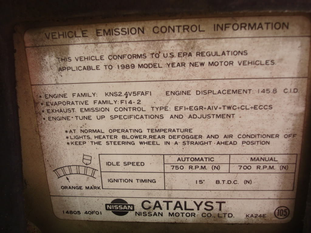

BUT TODAY:
my Friennd Cr8zydrifter came over, and ON HIS HOOD there was an OEM STICKER
that said THE TIMING SHOULD BE SET AT 15 ? ? ? ? ??
Whats up with this?
his is a KA24DE.

Old Sep 7, 2008 | 10:55 AM
Cr8zyDrifter's Avatar
Joined: Feb 2008
Posts: 99
From: Texas
Mine is a 93' with DOHC KA24DE
I guess the hood was from an older 240, we didn't look at close enough

Old Sep 7, 2008 | 12:24 PM
Rotary_tech's Avatar
Joined: Jul 2008
Posts: 74
From: Bay Area
the hood was from an 89...and it's a federal emission standard car.
