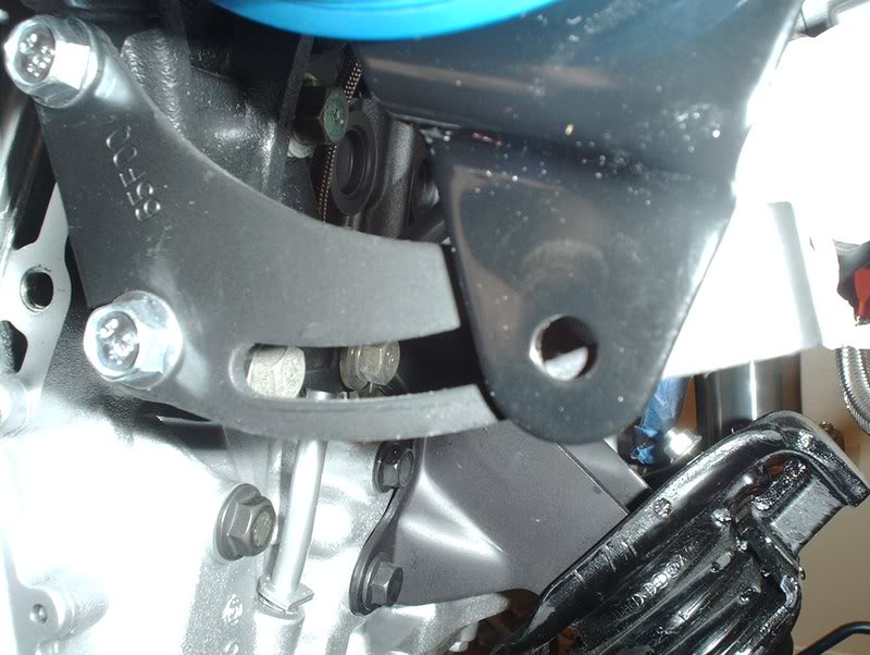

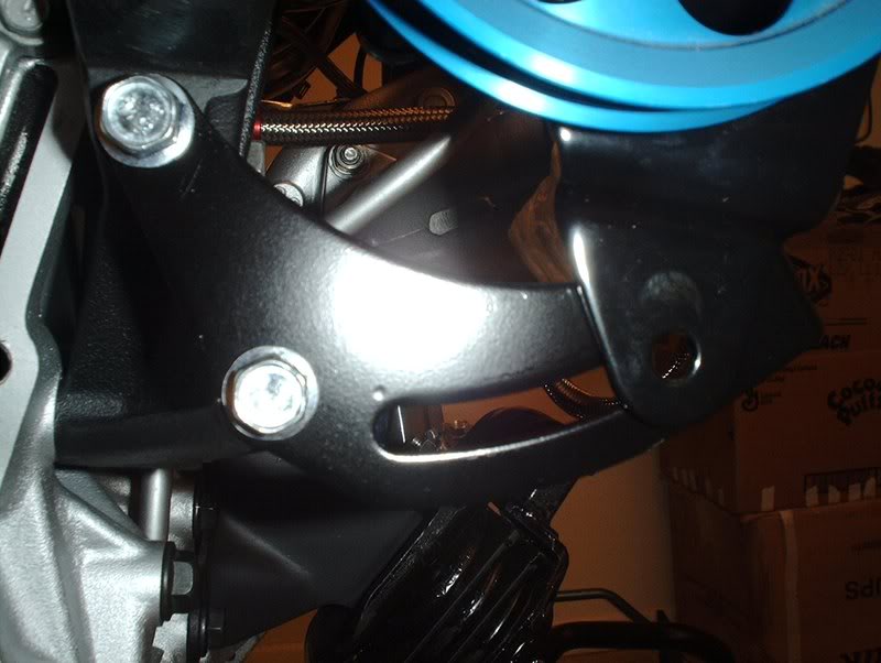

If you use the KA pump then you will need to get this black bracket(adjuster bracket) with the two shiny bolts on it off the SR.
This is a SR pump with the KA adjuster bracket and as you see it does not line up.

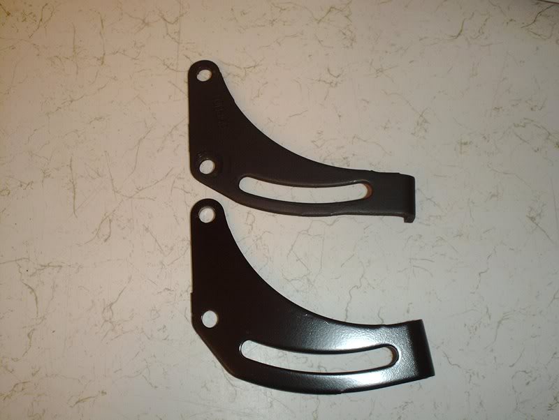

KA on the top and non-HICAS SR on the bottom.

Now it works!
