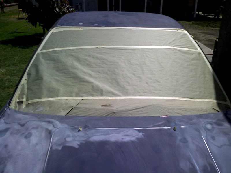

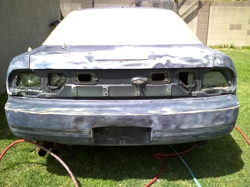

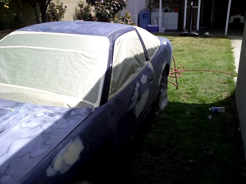

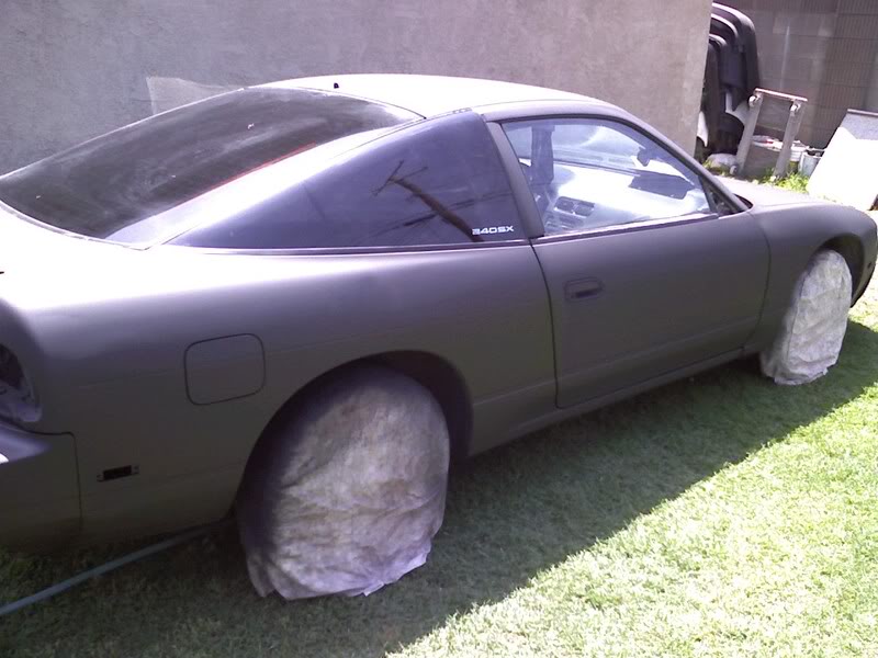

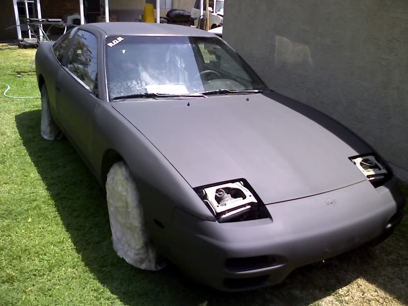

im finally done with the paint!
it came out pretty good in my opinion
anyway here are the pics of the car being prepped for paint

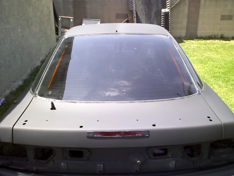

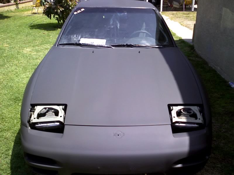

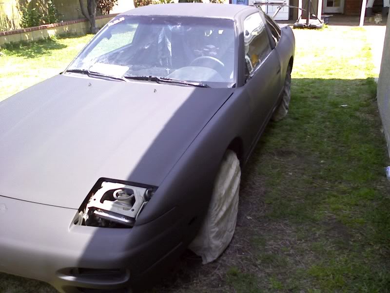

and here she is done...

ill be putting everything back together in about an hour or so...
the primer might look a little off in the pics cuz its not completely dry yet
but it came out pretty even

Looks good man. Can not wait to see how it will look with all the parts

clean work bro.... im going to be painting my beast when i get back...... what did you use to sand it....... looks like air tool.
if you are going to leave it primered make sure you spray it with a primer sealer and or you will invite rust from with-in
you could easily get some automotive rattle cans. the new duplicolor cans are good bro now with the fan tip.... very quick decent paint job. your prep was goood and with 2-3 coats of duplicolor and a wetsand you will be on your way and its easy to respray once you bang something...also you wouldn't have to lock it with a sealer.
but eh its your project dude.. keep it up.. good work

lol i know it looks like everyone elses but my thoughts is i dont really wanna worry about the cosmetics too much yet im focusing on performance first so for now its fine
and yea i used air tool to sand, i got lazy lol
