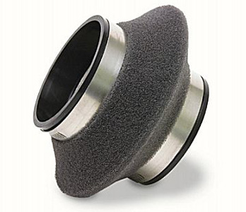

BTW, with the CAI, are those still a problem if you live in a wet area? I remember hearing a couple years back that they weren't a good idea if you lived in a place with a lot of rain 'cause it could suck the water right up into the intake. If that's too big a risk, I'll just get a normal intake.

Ok, to correct myself. By cold air intake I meant the short ram type. I agree that in a wet climate (Like here in Chicago) the cold air extension will soak your mass air sensor. I have been using a short ram intake (AEM) and have had no problems with water, even with the entire stock air box removed (that box stuffed behind the driving lights too).

AEM makes an attachment for their CAI that is supposed to get rid of the water problems...i forget what its called however...

Yea, I remember a company had a 'valve' of some sort that would detect water, and then close off the cold air extention or something.... AEM, huh.... I'd be curious if it really worked! 'cause it does rain a bit up here in Washington. Like today; good reason to get the car sideways (although not always on purpose....)

The "valve" is called an air bypass valve by AEM. It has a foam filter and underneath are spring loaded flaps that open when there is too much vaccum at the filter. I.e. when there it gets drenched by water or is just dirty. It gets installed by cutting the cold air intake and splicing it in, hopefully before the mass air sensor.
If you get an intake that places the filter roughly where the old intake box (short ram) was you won't have a problem with water. I have driven in heavy rain at highway speeds and found the filter dry as a bone. In this case the bypass valve is a waste of money. I have seen it installed in a Civic and a Qualude (prelude) with a short ram and it has never opened.
