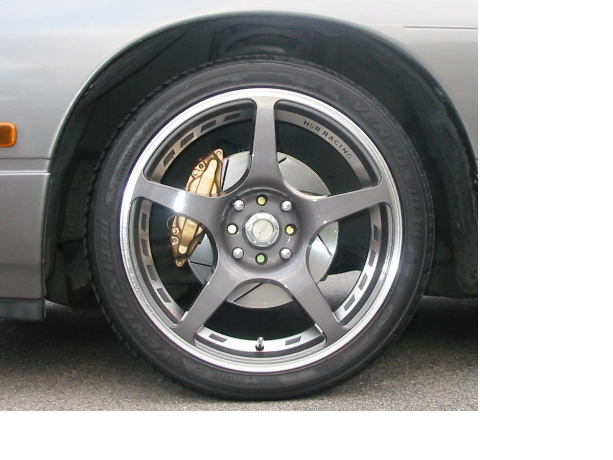

Actually, I answered all the questions earlier in the thread, but here you go:
1. Where'd u get it at?
pieced it together from many places
just keep this in mind......if you buy 300ZX brake calipers, they will not come with the hardware for the brake pads....which includes:
4 - Pad Pins ($9.32)
2 - Pad Pin Clips ($11.98)
2 - Spring Clips ($7.06)
1 - Front Brake Hardware Kit ($50.81) includes....brake pad shims, grease, etc....
So that's:
$80 brake hardware (http://www.courtesyparts.com/)
$53 SS brake lines (www.splparts.com)
$60 300ZX EBC Greenstuff Pads (www.tirerack.com)
(~$240w/tax minus $120 core) 300ZX calipers (Autozone)
(~$130 to $200) (300ZX rotors, keep in mind you'll have to get a machine shop redrill) or get KVR xdrilled rotors already drilled for 4lug from www.pdm-racing.com ~$270 shipped)
2. Is it simple bolt-on?
yes, simple bolt-on; EXCEPT, you'll have to cut off your old dust shield to accommodate the larger rotors, and I had to use a dremel to grind down the caliper so that my 17x7 40mm offset wheels would clear
3. All together u payed only $550 for everything?
after getting my core money ($130) back, yes, around that ......you should be able to do it for about $570
4. Those are the 4 lug or 5 lug brakes?
4 lug, i had to have my 300ZX rotors redrilled by a machine shop for the 4x114.3 pattern
Why do you want 5-lugs, there really is no advantage to 5-lugs except a different selection of wheels, if you did a 5-lug conversion, you'll have to buy spindles and a bunch of other stuff.

wow they really fit your wheels good
16's?
Old Mar 6, 2005 | 04:30 PM
  #40
badman70_1's Avatar
Posts: 136
From: Nashville, TN
16's?
17x7 215/40/17 (front) +40 offset
17x7 225/45/17 (rear) +40 offset
with an offset this high, i had to use a dremel to shave off the "NISSAN" lettering and some of the caliper so it would clear the spokes.

nice set up, looks clean too, but out of curiousity...when you say redrilled you mean you got the 4 holes drilled in with the 5 holes for the 5 lug still there as well, so now you have 9 holes correct? now i don't mean for this to seem like i'm flaming, but i personally think that's a dumb move... the lessens the integrity of the rotor itself, and isn't a safe thing to do. also i too reccomend doing the master cylinder and rear upgrade, yes i read and understand where you are coming from as far as price goes, but the way i see it is that a car doesn't have to do anything but stop. like i said before i don't mean for what i said to come off wrong, it's just my two cents.
