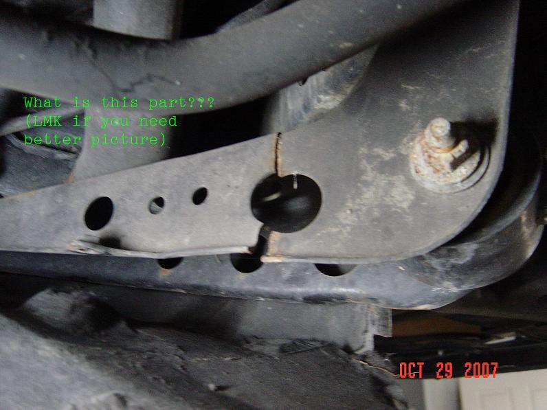

alright guys, i forgot to mention the steering issue i have. It didn't cross my mind cause i thought i would just look at it and find out what was wrong with it this morning then order the parts today, but im not sure what the issue is.
So to start, driving the car is difficult, when you turn the wheel, it doesn't center itself or even make an effort to. It just stays the direction you turned it, you have to force it back to center.
So this morning i disconnected the tie rods, thinking one of them might be stuck, but they both move freely and the wheel assembly moves freely as well (disconnected). When i connect them again, it turns hard, even in the air on the lift (car running or off, so i dont think its the p/s pump). I also disconnected the u-joint at the steering column/steering rack point, and that moves freely as well (the joint it self moves freely when off the car).
So I am thinking that it is the steering rack, what do you guys think? Has anyone out there had a similar issue like this before? I just don't want to buy a steering rack to find out its the p/s pump or vice versa.
Oh, and heres some pics of the underside!
Any help would be greatly appreciated.

I dont know, but I'm pretty sure that that 2nd picture is what they call "not good"

yea, if i can't find one of those, im just gonna have my dads friend (who's an awesome fabricator) just fix it. But i'm gonna search a lot for one before i do that. But for the condition of the body I still think its a great start for my project!

-no thats a REALLY good excuse to buy the nismo power-brace.

thanks clubred, i was wondering what its called and if there were any aftermarket upgrade ones out there. Looks like i'll be ordering one of those in the near future.

Ok what you have there is just the front bracing for the car. The reason your steering is messed up is because ifyou notice one of the main suspension pieces for turning the Tie Rod connects to it.
That is a very vital piece of your car. Also the Nismo power brace is the biggest waste of money ever. If you want a nimo power brace just buy some 3/4 or 1 inch round bar that will span between the two front supports and have them welded on and Ta Da Nismo Power brace for 1/100 of the cost.

yup thats no bueno!
