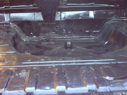

what i did on my prevoius s13 was take my air chizel and pop it all out
it was cold outside so it came off in huge chunks
the left over residue was easliy removed with brake cleaner and a scrubbie(like a grill brush)
i first trried a heat gun and paint scraper
it was a slow process...not worth it
get some dry ice, freeze it and chip it out with ease
