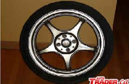

Hey, im interested in buying these mags and wanted you guys opinion on them, this is the description he provided me with:
5Zigen FN01R-C's in bronze. These are a 17" rim with a 4x100 bolt pattern and +42 offset. There are not curb marks or chips on any of the rims. The tires are dunlop fm901 205/40ZR17 and only have three weeks use as do the rims. I will also include Zenki tuner lugs for these. Price is obo.
he is selling them to me for 1100$ canadian , pic is below tell me is that a good deal itsl ike 900 USD
240's are 4x114.3 or 5x114.3 not 4x100.
and +42

yeah, +42 is pretty bad

thoes will fit a civic,,, integra,,, dodge omni- charger 2.2 and a few other fwd cars... but if you want them for your 240... they aint ever gunna fit...

whats a good offset
Old May 22, 2005 | 05:01 PM
silviadriver's Avatar
Posts: 612
a good offset will be determined after you have decided a width
Old May 22, 2005 | 05:09 PM
Fast1One's Avatar
Posts: 2,863
From: Waterford, Ca
If you really want FN01R-c's get either 17x8 +35(old model) OR 17x9 +20 (new model) This is for a 4x114.3 bolt pattern. If you have a five lug s14 your choices are more open....This belongs in the tires/wheels/brakes forums by the way. Check out the sticky in the latter forum. Hope this helps.
