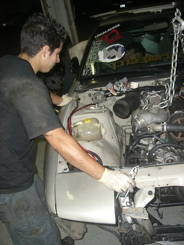

Took out the dash and started removing the body harness, we are planning on deleting most of the harness to run the only the necessities..

Still in the process of removing everything out of the engine bay:

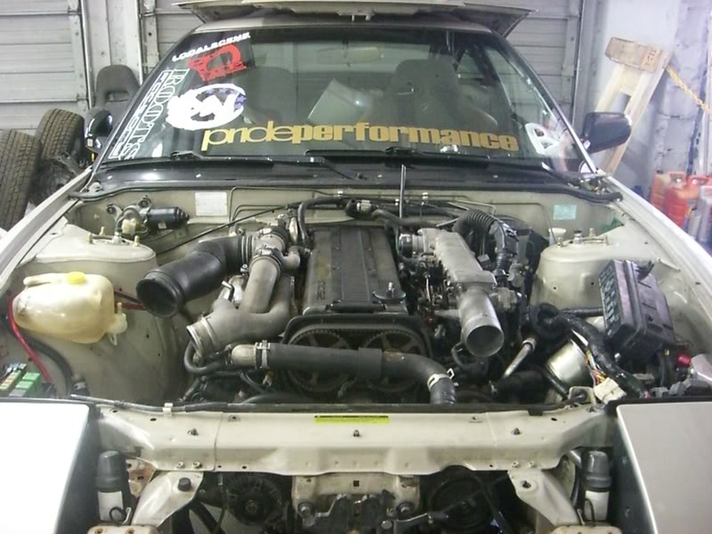

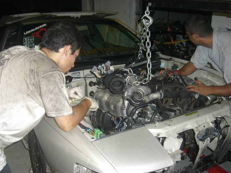

Us trying to figure out how to mount the motor:
we finally got it in but i wasnt to comfortable with the way the oil pan was sittin, according to Tech 2 you have to space out the sway bar so you can fit the oil pan. I said **** that and started marking the pan so i can notch it to make it fit:
next up is the shifter, here is where the stock location would be on the r154 trans. Im in the process of fabbing up the shifter extension:
So we took the motor back up and made a mock up oil pan and put the motor back in:
And wala heres how the motor sits, we have it on 2x4's on the the mounts so we can mock up the mounts tomorrow:

Now that the mounts were on this is how that motor sat ( to tell u the truth it fit better than my rb)
