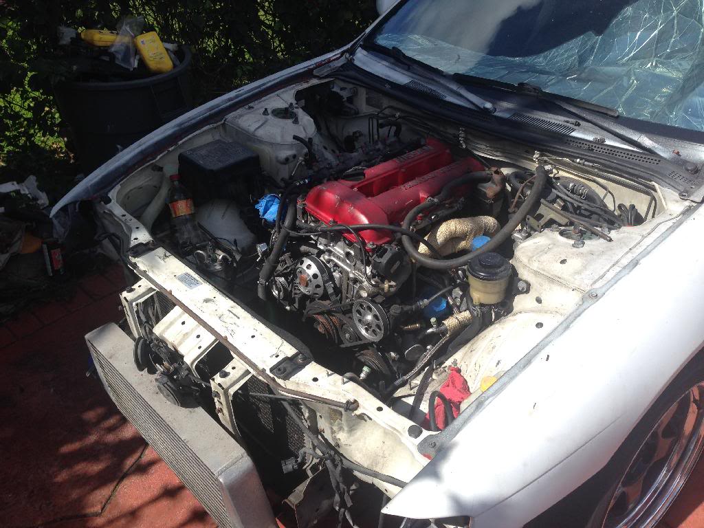

got the engine in the car finally

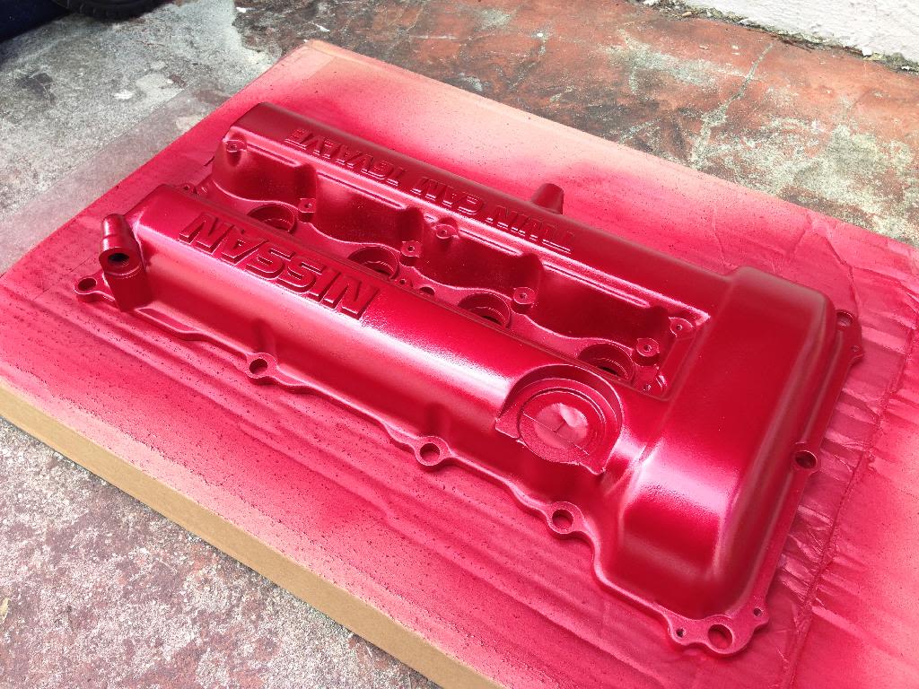

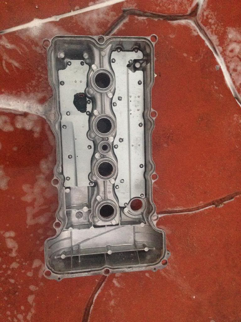

removed the valve cover to paint it and put new seals on it and found my head to be quite clean for an engine built in 1992
i do change the oil mobile 1 every 3k miles
all it took was a little degreaser and a hose, no scrubbing at all to get my valve cover looking like this.
Metallic Redfire Pearl
all cured with clear coat on
