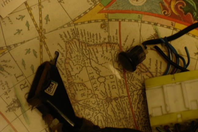

I purchased it but now i need to know what sensors im missing the only one i know what the hell it is is the Round thing which is the sunloader sensor and the other one which looks like an intake of somesort? I looked around google for info but im lost otherwise here are some pics. I know i need a few other things but unsure which ones. They can be interchanged with the ones from an early 90's maxima and therefore i need to know what else i need.

The intake looking sensor sits behind the centre console panel just under the DIN slot

it normally friction fits around a bevel on the back of the console insert - as you can see it has foam on it to make a seal with the insert. The console insert (the piece of plastic that goes around the gearstick and up around the din slots) has a grille cut into it, about 1.5cmx2cm above and to the right of the gearstick
its just an ambient sensor so i reckon you could mount it anywhere around that general area
