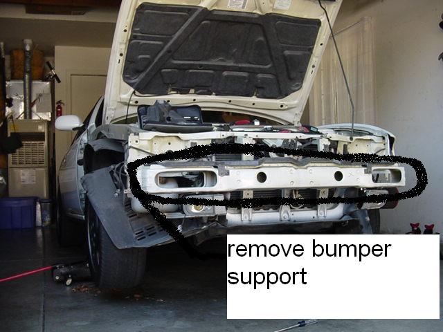

the s15 bumper wont fit with the s14 bumper support still attatched remove the four 14mm bolts behind it to remove

really cant mount an intercooler after conversion? since your missing that re-support?
Old Sep 12, 2003 | 08:52 AM
Sizzzoooo's Avatar
Posts: 754
From: Murfreesboro, TN
yes, you HAVE TO remove the front bumper support to mount a FMIC. The mount for the IC actually goes on the mount where the hood latch is.
