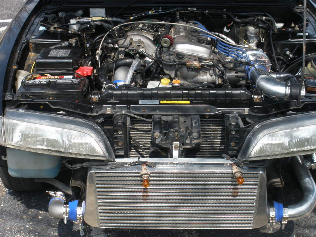

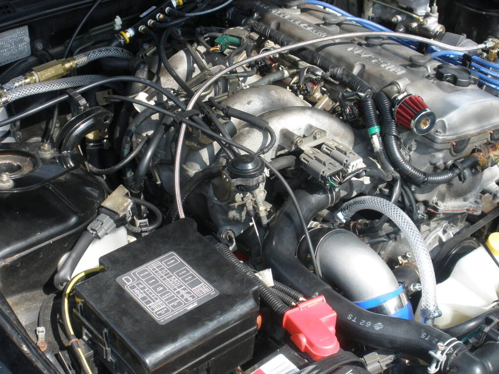

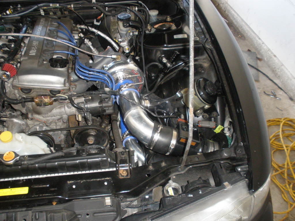

On with the pics....

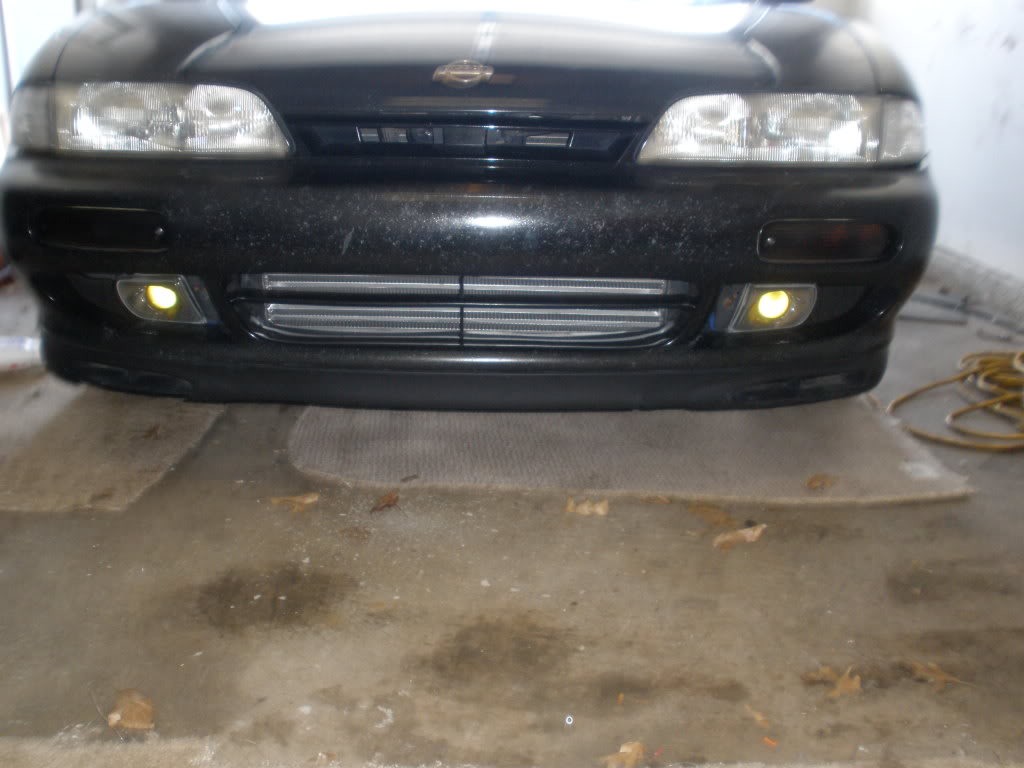

Before intercooler install

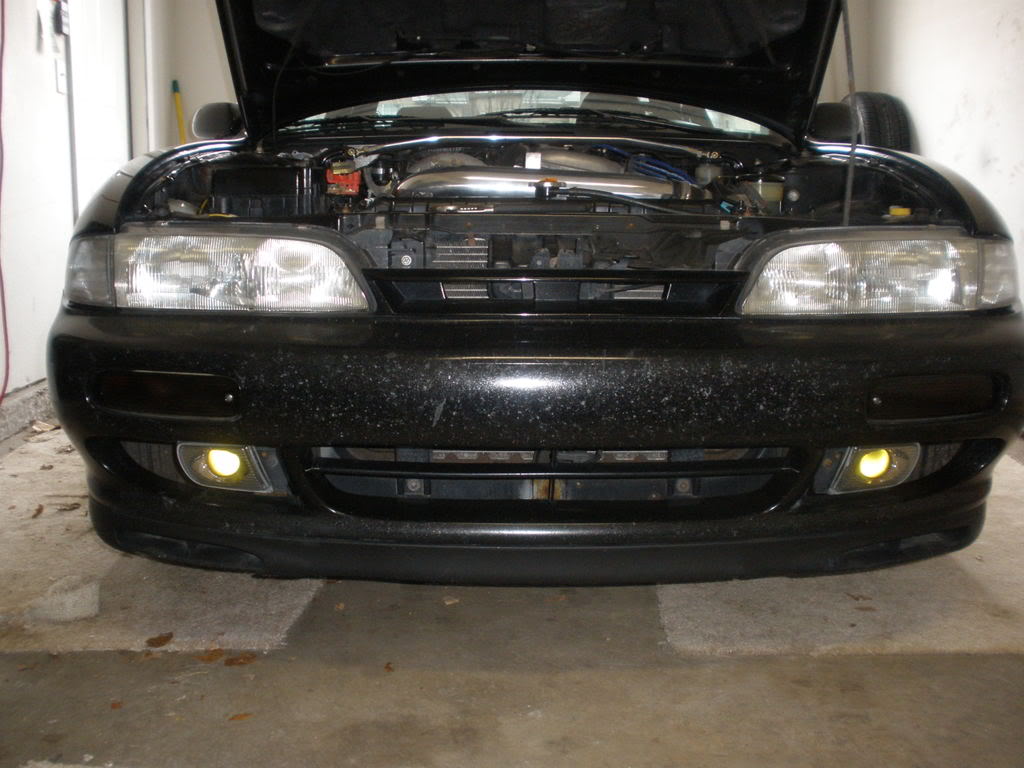

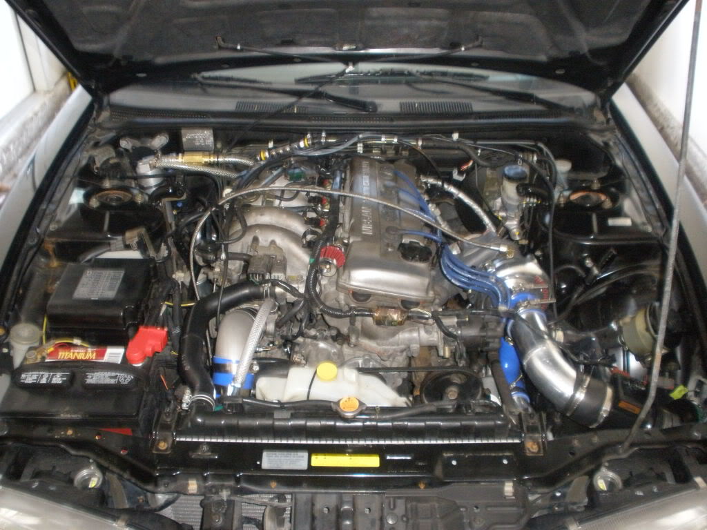

after

I was very happy I could keep the fogs in stock placement.
I went with the godspeed kit so I didnt have to relocate the battery. It's not a bad kit for $300, it's identical to the greddy kit. I was able to keep the a/c too!
I only have 100 miles on so far, still breaking in the clutch. I'm going to run 7- 10 psi, thats about all i care to take it to with motor having 169,000 miles on it.
The open wastegate dump sounds bad a**, but i'm eventually going to route it back to the exhaust.
Over all i am very pleased with how it came out. I still have a some odds and ends to take care of but its fully functional right now.
What do you guys think?

looks nice i like that intercooler set up

I was impressed with the intercooler set myself, it didnt turn out that bad. No dyno numbers yet but I plan on ot after I break in my clutch. I will do a run with 7psi and one with 10 psi. I hope to be at 275 rwhp at 10 psi.
I had to replace the bov recirculation tube with a radiator hose I bought from the parts store today. I was having idleing problems from the recirc. tube being kinked.
I highly recomend this intercooler kit, if you have a an s14 and want to turbo it try this kit over the sr kits. It worked great for me useing the JGS kit, the only thing I had to get was a 2" 90 degree coupler to finish of the hot pipes.
