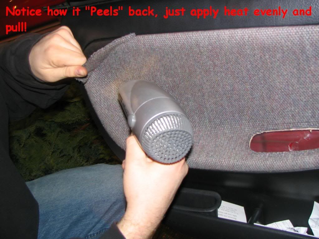

Originally posted on 240sxforums.com:
Old Apr 30, 2006 | 05:52 PM
works with s14 too

how dumb am i to never even think of taking that ugly **** off.
as for the glue residue, does that crap come off completely?
i'm a little skepical about whether or not it is going to look worse when i take it off? hm...
maybe i should just spray them black first, and if that looks like @ss then i have no choice but to peel it off.
i would just take it off, the goo gone will get it off. my friend did it and it looks great. and as for the holes, if you aren't TOO worried you can just cover it up with permanent marker or something like that
but yeah, definately go with stripping it off
