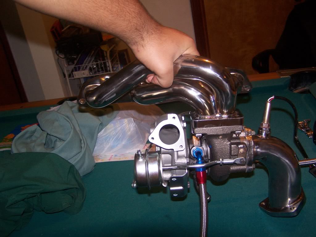

your turbo looks wrong for some reason
i know this is a new turbo and a different manifold with no elbow but by looking at it you can tell adding a elbow wont interfere with the manifold.
yours just dosnt look aligned right
