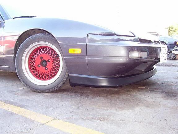

Hey guys, I was wondering I saw this 84 mustang GT, with 4 bolt rims, They were the drifting style rims, the 15" black with chrome lip. I was wondering is it 4 bolt or 4x114? anyone help? I might buy em if they fit
Those exact rims, But the red was black.

yeh theyll fit....im pretty sure the bolt pattern is 4X114.3
Old Jul 31, 2006 | 08:45 PM
1984 is the foxbody?
in that case they are 4x4.25" where the 240sx is 4x114.3 (4x4.5")
so, no they will not fit.

as ayuaddict mentioned they are 4x4.25 or 108mm
