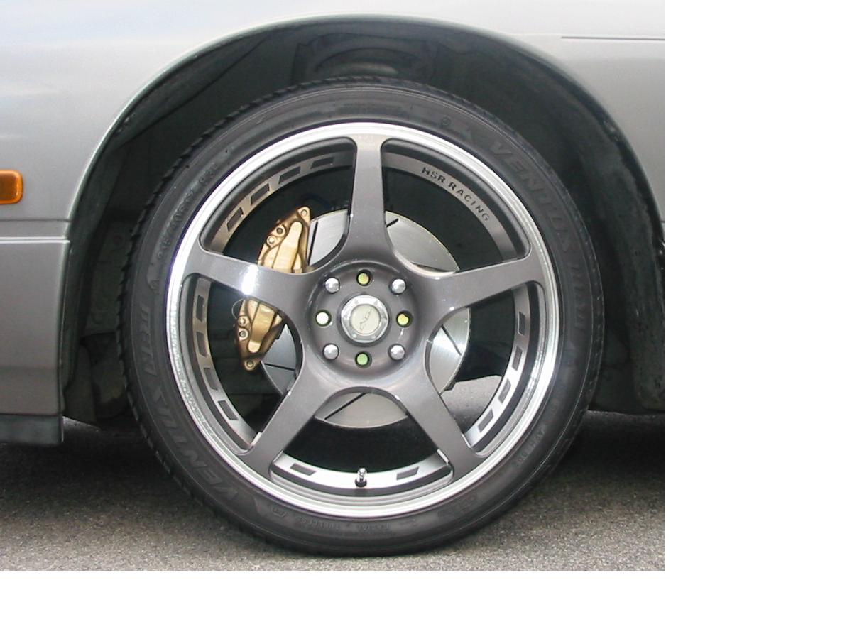

@ autozone, the calipers were $50 + $60 core each
$220 + tax. just don't forget that these are just calipers....no brake hardware, such as:
pad pins
pad pin clips
spring clips
front brake hardware kit (brake pad shims, grease, etc)
all of this will run you around $80-$100
here's a pic of mine:
