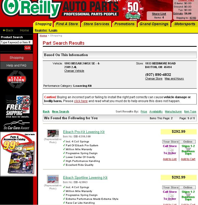

I would like some ideas on cheapest (i mean f**in cheap, i got 2 kids man!)decent lowered coils i could get for my 93 fastback. And if anyone knows if they will be OK to use with the factory rims and 55 series tires. I dont want it too low to bounce tires off the wheel wells! I want the stiffest possible ride. I cant stand when they advertise, progressive rate springs , what does that tell you about how stiff they are, what is the spring rate and what is the curve as you compress it. Anyhow best deal i have found from searching is these Eibach ones at OREILLY Autoparts. Cant wait to hear some suggestions. THANKS
