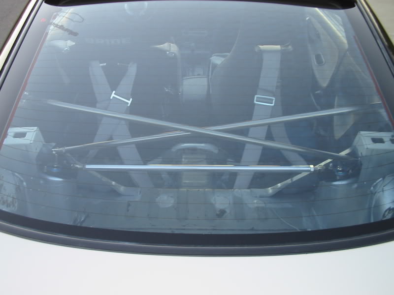

Old Mar 1, 2007 | 01:06 PM
JDMxDrift's Avatar
Posts: 707
Boom Shakalaka. There you go boys.

Cool...you used two c-pillar bars to make that? How did you do it?

You have to flip some of the brackets around to lengthen or shorten the span of the bar. I connected them from the rear upper seat belt mount to the strut mounts. To make them cross, one has to mount to the forward bolt and one has to connect to the rear bolt on top of the strut mounts.
As for the performance, i did a lot of things at once. I added a floor bar as well. It made a noticable difference, when i'm going over huge speed bumps at work, i get three wheel motion which i never got before. When the car is up on jacks it is a lot more rigid as well. That is the only raw evidence i have for effected performance, but i'm sure the car will perform better once i get the chance to open it up.
