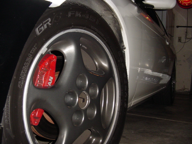

All you would need to do is to get the 240sx-300zx conversion brake lines. The calipers will simple bolt on. I say get those along with the wheels because they have a better offset and are wider(7.5front 8.5rear) and more flush. Here are some pics of the Z brakes and TT wheels on my car........
Attached Thumbnails found a 95 300zx tt with brakes still on it, can i use them on my 240sx-dsc01975.jpg

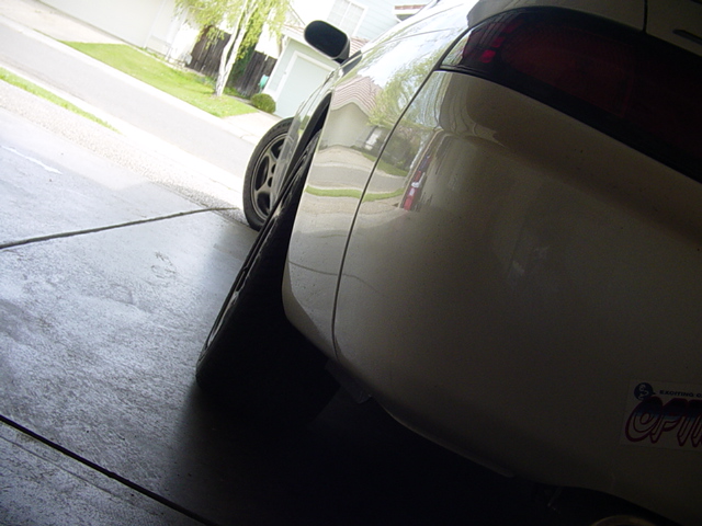

pic of the wheel flushness........
Attached Thumbnails found a 95 300zx tt with brakes still on it, can i use them on my 240sx-dsc01919.jpg
