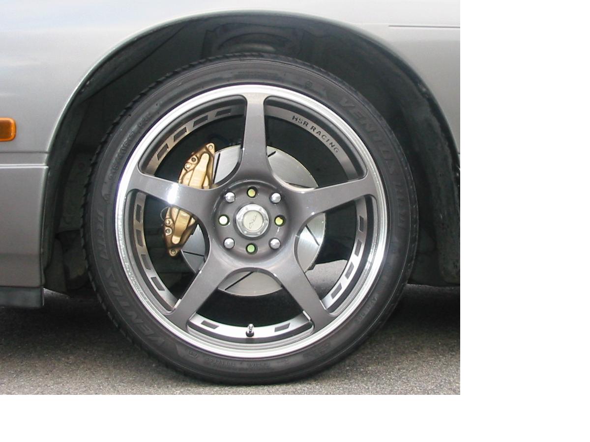

instead of berating you, i'll assit you with this recurring question.
i did the 300ZX front brake upgrades with iron 30mm calipers.
my wheels are 40mm offset. instead of using a 1/2" damn spacer, i used a dremel to shear off the "Nissan" lettering. even now, my wheel clearance between the wheel spokes and high point of the caliper is too close for comfort.(1-2mm)
since i painted my calipers, i just look for any missing paint to determine if the wheels are rubbing. it has looked good for 2 months now, i think the only way it will rub is if i do some hard high speed cornering that could possibly cause wheel flex?? with that said, do yourself a favor and get lower offset wheels.
i think the reason people get the fwd wheels are that they are so cheap due to the honda craze.
i paid $660 shipped. (wheels and tires)
here's my setup:

Old Mar 21, 2005 | 11:04 PM
JDMxDrift's Avatar
Posts: 707
Oh my friend had those on his VW Golf.
