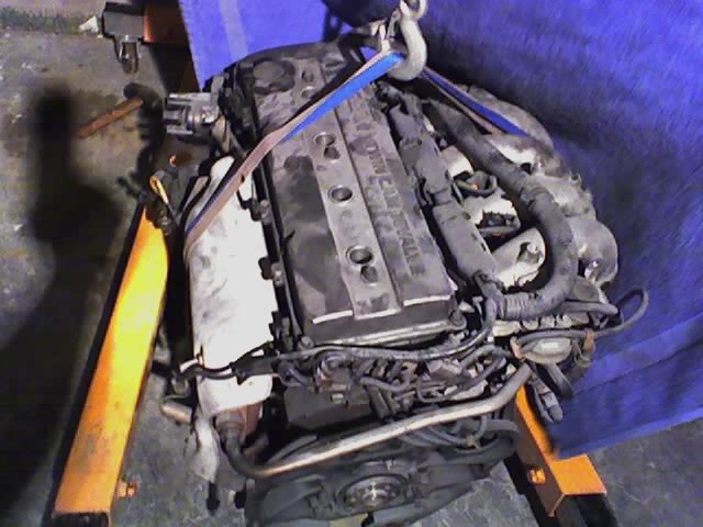

when we first got the motor... we didnt have any straps. but safety strap work well.

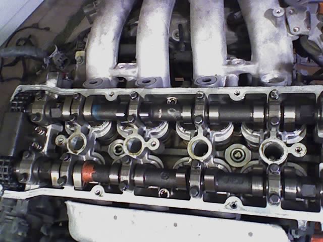

got the valve cover off...every thing looks good.

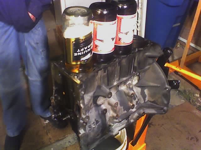

finally every thing is taken apart
that day took us like 4 hours to sort and bag bolts and clean and check EVERY THING. the block was sent to college the next day.
after all that we took this pic lol

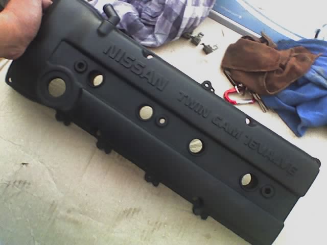

ong after that founds some free time to paint this. (used thermal paint) Name:  ka24devalvecover.jpg
