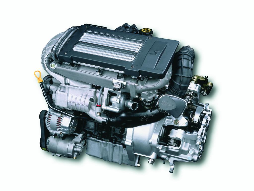

1. centrifugal superchargers make peak boost at redline.
2. "roots" style superchargers such as the eaton M45 makes it's peak boost at 1500rpm and hold's it to your redline.
3. the way that "bedbull" from nico set up his S/C is just about the best way that you can set it up to run on a KA.
if you dont think that it's possible her is a couple of link's:
http://www.rr-racing.com/Project.htm
http://www.precisionracingonline.com..._kit_main.html
i like the 2nd one better, i don't like the "driveshaft" on the first one.
Also he is a pick of the BMW Mini Copper S engine that the Eaton M45 comes on:
