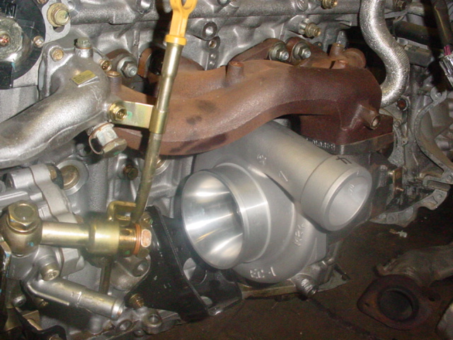

I am doing a turbo upgrade on my S13 w/ a red top, what do u recommend, I like this turbo in the pic, it is a garret GT25R, 400HP, but no lad, so I was told, but I want a killer street turbo, as lil lag as possible, but at least 300-400HP, so lem know what u think, guys n gals( lil hotties, he he)
Aslo a S15 stock turbo, maybe?

I believe the turbo from HT that sr180 is talking about is the same as the upgrade that can be found from Forced Performance. Its called the bigT28 upgrade, and has HP figures similar to what sr was talking about. Is the GT25R ball bearing Sil80guy? It sounds like that is the turbo for you since it fits what your looking for in spool up time and performance. The S15 turbo won't get you 400HP, but it will give you 300HP with proper tuning and such. I personally think the S15's turbo is somewhat over-rated. Even at 300HP, your at the turbo's limits, which is never a good thing. This would mean that the turbo would be at your maximum boost setting all the time. You really don't want that. Its alway good to have reserve on tap as far as the turbo is concerned. The main benefit to the S15 turbo would be minimal alterations to your existing setup, as it is a bottom-mount turbo and would replace your existing T25.

Is that the same turbo I see advertised on Phase2? Depending on the A/R you can get either 400HP or 450HP. And with some modifications to the motor mount it fits on the stock manifold.
