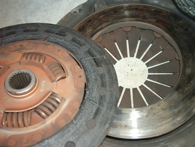

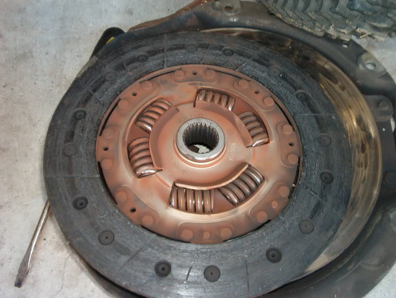

here are some pics of us doing it,
old clutch

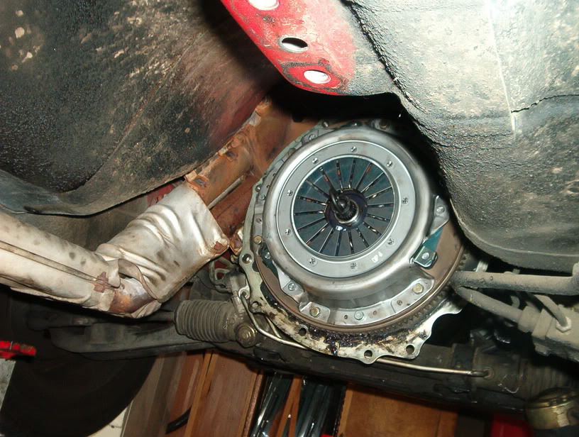

new clutch on

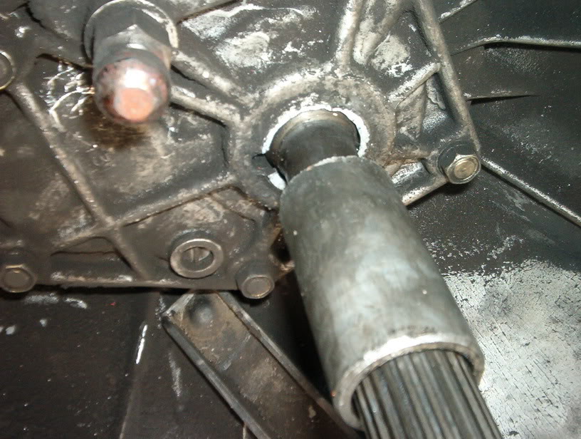

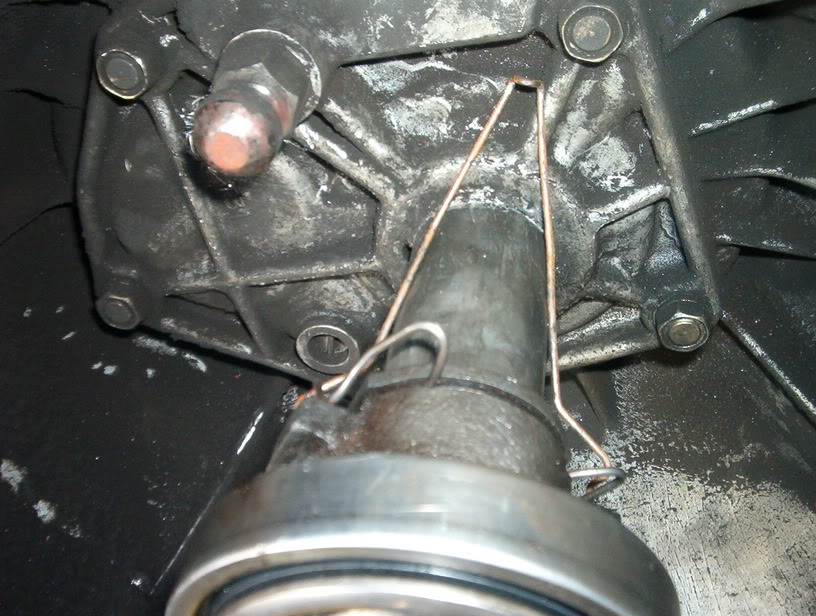

but we ran into a problem this piece broke off the tranny
can that be fixed or what should we do? it just broke off when my cousin(owner of the 240) was doing something with it

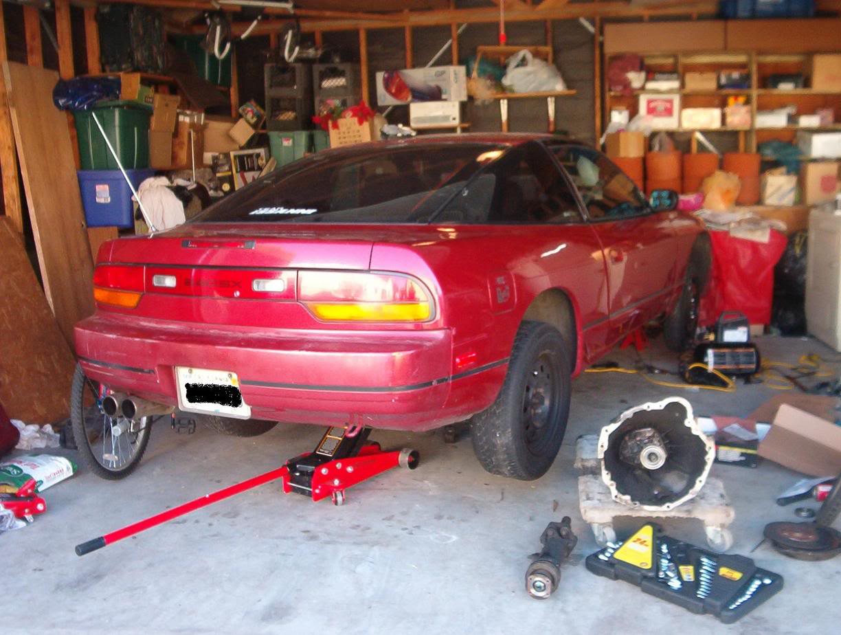

pic of car in the garage

dam that looks pretty bad, i would jus drop by a junk yard or any place that does swap, they should have a tranny laying around somewhere, i dont think it should cost much
