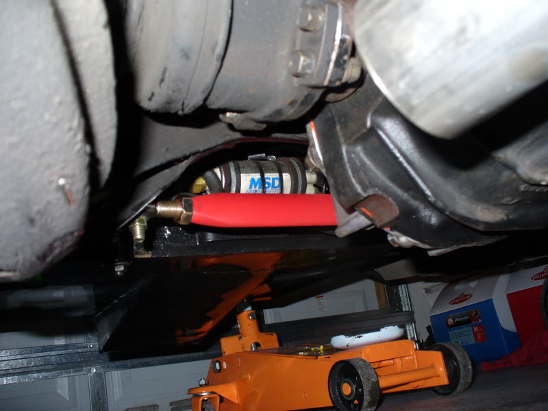

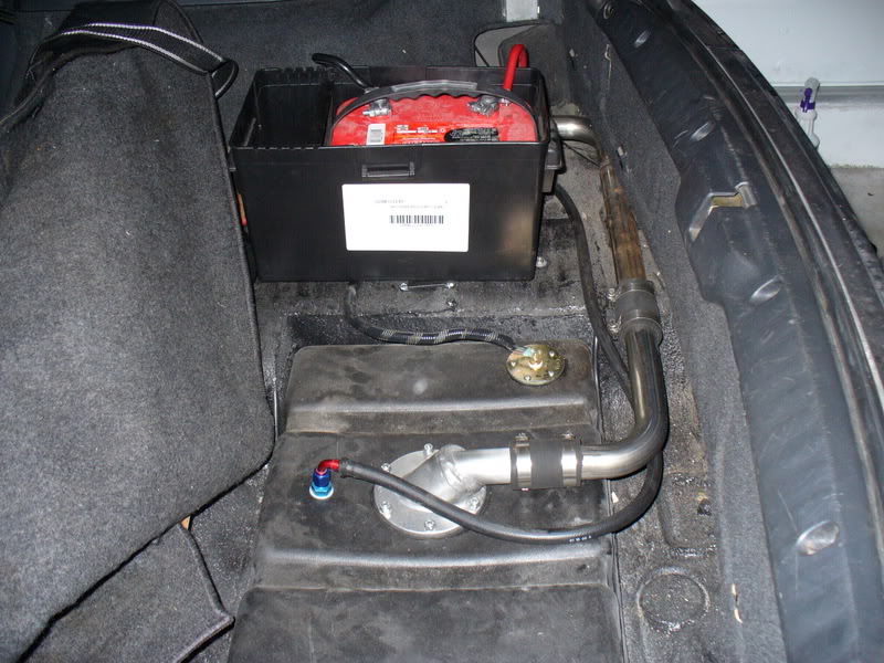

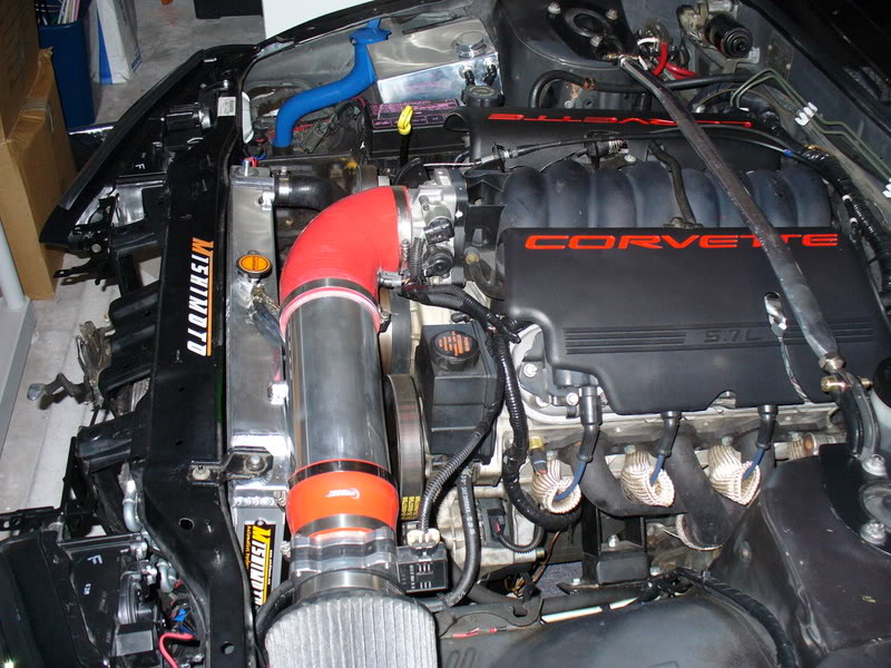

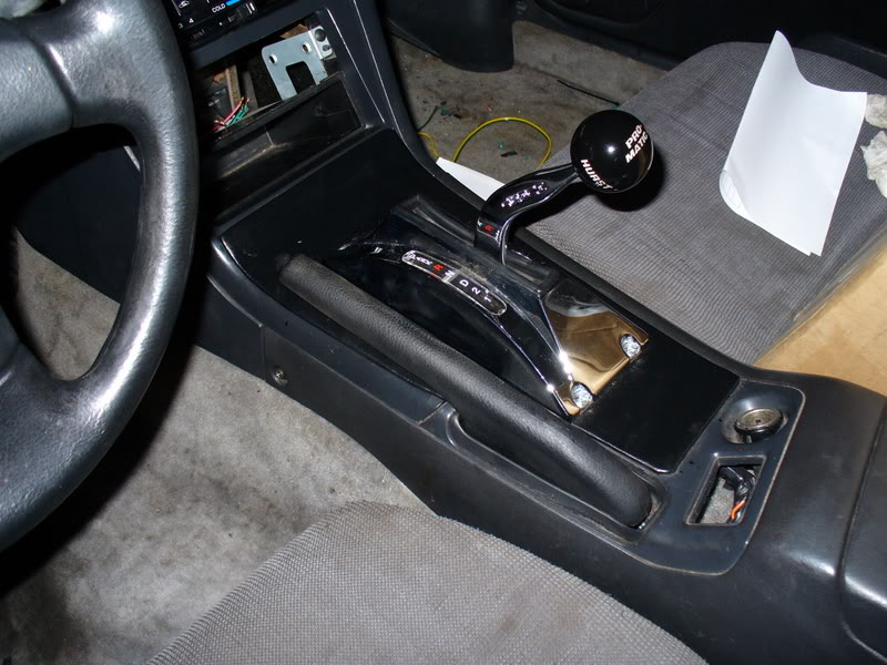

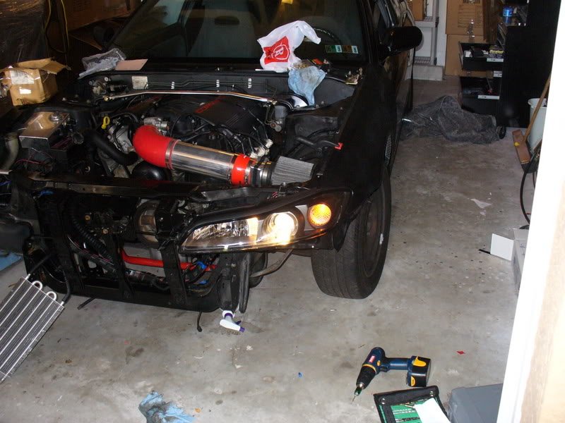

Yeah I went nuts with mine, total cost with Cusco 1.5 and performance mods ran me $12,000 but that 2300 for the engine, 1200 for the trans, fuel cell, performance mods, shaft, subframe mods, J30 6 bolt LSD repacked with a Cusco 1.5 way, and a complete new suspension. My bill was 8000 from the shop who did most of the work.
