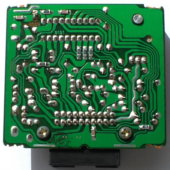

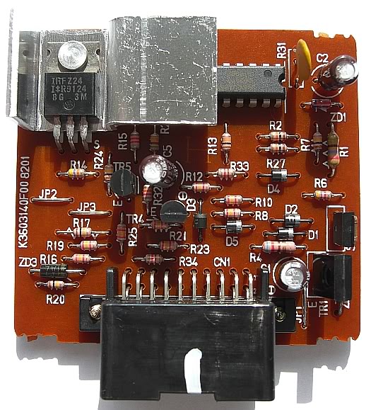

I removed the Time Control Unit and looked it over couldn't really tell if it was fried or not?!?! I am submitting a picture, hopefully someone can direct me where to look!( plus out of all the threads I have read related to this issue I didn't see any pics of this piece)

I checked all fuses and they are fine. The only thing I haven't done is replace the dimmer switch ( I hear you can trouble shoot it or jumper around it but I don't really know how to do either) and 2nd remove the cluster to replace bulbs! I do need to take the cluster out soon to work on the HUD display unless the 2 issues are linked! Ugggg these electrical problem are soooooo time consuming and tedious! I spent all of yesterday afternoon farting around with this!
