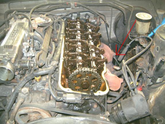

here ya go
Attached Thumbnails '89 240sx (S13) O2 sensor ghetto rigged to computer-o2-plug.jpg

Thank you, but I really need to see where the plug is coming out of the main harness. I know, I know....beggars can't be choosey.......sorry.

follow the wire in the picture?
