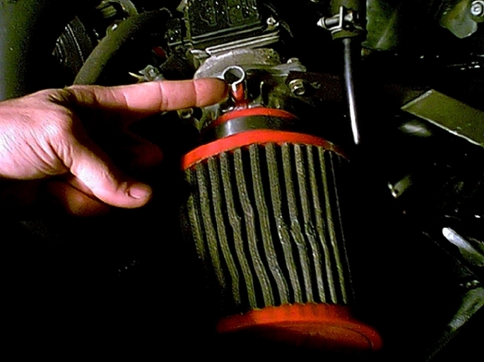

Air intake
In between the MAF and the cone i replaced the aluminum flange with the one from the KA so that the cone can fit on top of it, there is a thin long flange coming off of this aluminum piece that used to hook up to the EGR on my KA
Can i use this in the SR? and is that where i attach the SR EGR to?
Thanks
(in the pic im pointing to the flange on the part im using from the KA)

Thats the tube that goes to the AIV, REMOVE THE AIV, it's a free mod that frees up space and will help your engine a bit. All it does is warm up the catalytic converter and help w/ emissions, I took mine out and love it. NICO has a sticky on the how to
Dr.
Dr.
Right thats what i thought, so i can just plug it up and im good to go.
thanks

yeah, 2 hoses you'll need to plug up so you keep the vacuum, and the exhaust piping you can weld or just rubber it off.
NP
Dr.

what will happen if you need to i/m your car but already taken of the AIV, will you still pass the test?
Old Oct 30, 2003 | 04:14 AM
Doba's240's Avatar
Posts: 267
you put it back on for the emissions test, thats why you seal the hoses in some way you can easily unplug them.
or in my case ive got a guy who i pay $150 for emissions and he doesnt even open the hood..WORD.

I was told it won't affect your emissions that much @ all, but yeah, take a whole 10 mins and put it back in one day a year, heh. NH doesn't have any emission laws.
