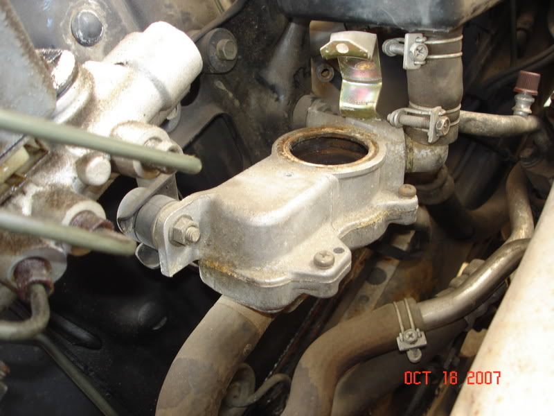

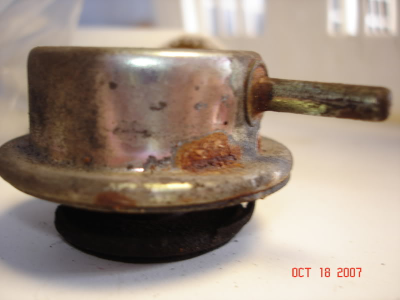

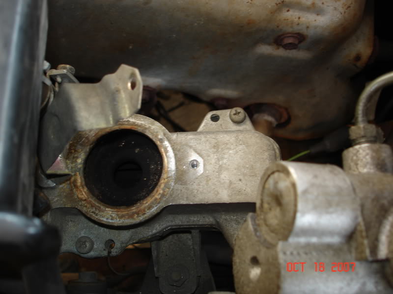

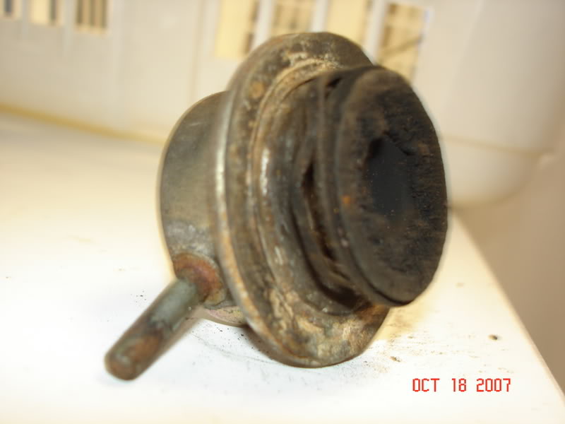

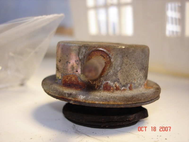

hey guys
i have an 89 240sx that is throwing code 32, which is egr function (cali cars only)
well, i have traced down the problem, but now i cant find the part to fix it. i think that it is because it is a cali car.

that's the aiv not egr.

ok i figured it out, it is the air induction or injection valve. but its still ****ed. where the hell is the egr??

The EGR is at the rear of the engine, and wraps around to the back of the intake. If i remember right, the valve is right behind the motor. That was on the KA24DE though, it might be different for the KA24E.

nope both engines have in the same location. just follow the tube just above the o2 sensor.

i found the egr, and decided not to play with it. anybody know what usually causes code 32??
