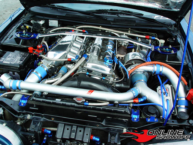

my fully built motor
all in an s13 blacktop
