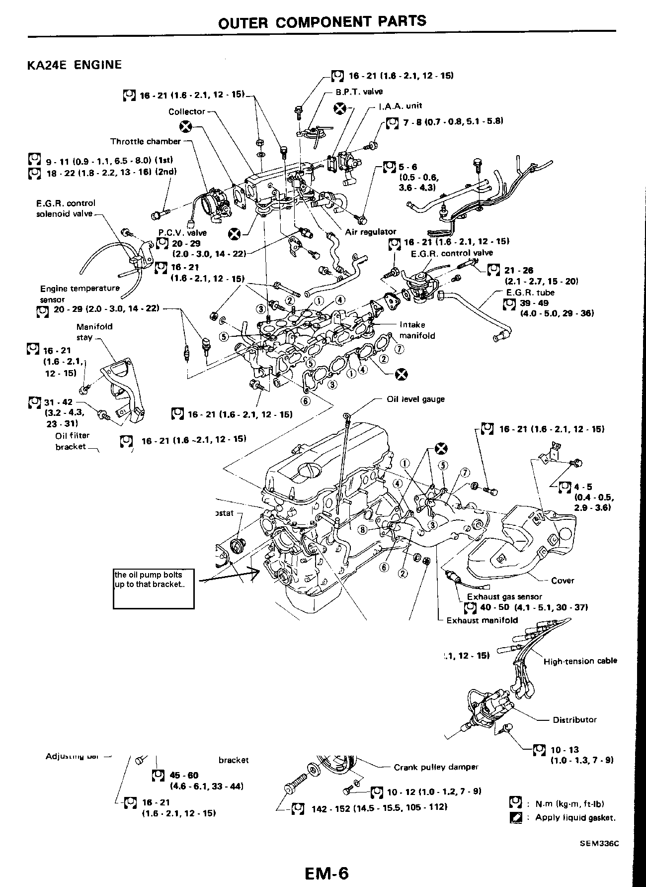

Hey sorry to ask you this stupid question, but I was wondering where the oil pump is located ont he engine, sorry I have no acces to the FSM.

here is an edited pic to show where the oil pump bolts up to.

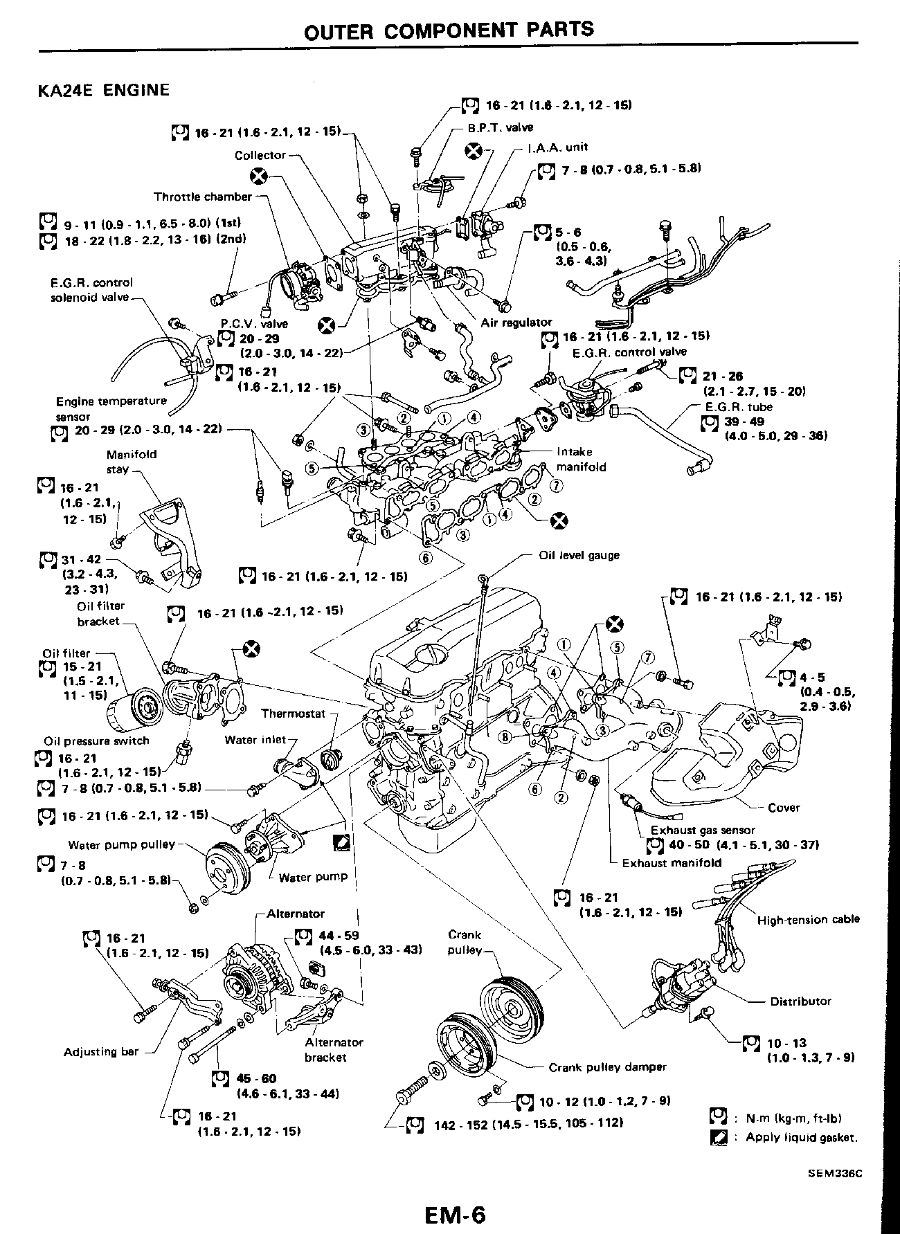

i'm not sure where i got it from.... here is the unedited pic for those it might help out.
i have one or two of them, but if you want a new one OE or aftermarket i can get them wholesale if you want me to.
