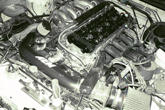

has anyone changed or fixed thier oil pump?
I was wanting to know if there was a cheaper place to get an oil pump rather than pay $300 to nissan parts . that is outragious for just 2 gears.
Old May 27, 2003 | 07:12 AM
Justin.b's Avatar
Posts: 680
From: Massachusetts
The pump is integrated into the front cover assembly, so that price includes the complete front cover.... still damn pricey but that's how Nissan does it.
-Justin
Old Jun 4, 2003 | 04:22 AM
dkdeleon's Avatar
Posts: 593
From: arlington texas
thanx I just got finished with it and It was the regulator valve in the oil pump, the spring was cocked sideways I also changed the timing chain and cam sprockets . helped even more.
