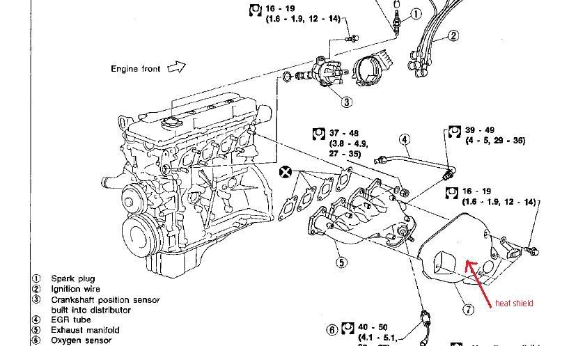

Old Dec 15, 2007 | 01:05 PM
Thats the heat shield on the exhaust manifold, I cant remember if theres one on the downpipe or not and I cant find it in the FSM right now.

sweet thanks but part im not getting is if i tighten that up, if it even needs to be, I dont see hwo that would stop the rattling even though it must be coming from that.But to me it more sounds like its grinding or something.
