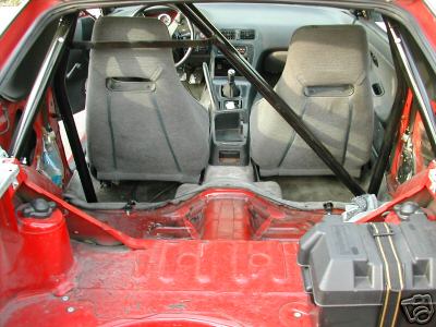

If your serious remove rear interior, sound insulation, all speakers, stereo, battery relocate, rear seats, spare tire, jack, carpeting. I also went with carbon fiber hood, fenders, and no AC. I saved about 270 lbs.
