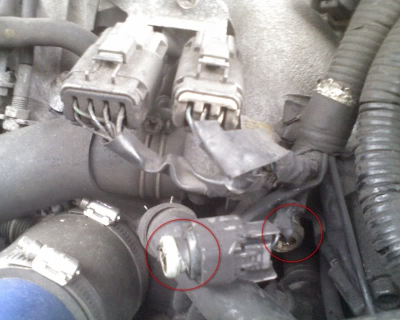

Anyone have any idea what sensor this is? Anyone have one or where i can find it? If so, please let me know.
Thanks

thermal sensor it looks like.... why did you break it??? lol
can you get a frontal shot of it... I honestly have not seen or worked with a stock manifold in a long time..
Hahahah beats me. I didn't break it... i notice it broke off. I was like WTF is that??!! LOL....
Which frontal view did you want? the male or female part of it? hahah LOL

HAHAHAH lol
like take a more clear picture of it. I cant access my FSM's right now becuase im at work. If you look at the engine diagram it will point it out.
Dude, its late as heck out now.... i'll take a better photo of it tomorrow. hahha....
I checked for the part at courtesyparts.com and this is what i found. I wonder if this is the right part.
Weird thing is, mine doesn't look anything like that.

that first picture doesn't show me enough to really know what i'm looking at. but i am possitive that it's neither of the two temp sensors you are asking about.
Old Jan 25, 2010 | 01:55 AM
it does look like the water temp sensor somewhat... also It looks wet.

I figure it out.... its the Engine Coolant Temperature Sensor.
I know what it is... it reads the temperature of the engine of course.
But what happens if its dysfunctional? What does it do to the engine?

Ok so i went to the auto parts store and got a Coolant Temperature Sensor to replace it and its a totally different plug.
Is it not the engine coolant sensor???
I looked it up on the service manual also and it did say it was the engine coolant sensor as well.
Not sure why its not working.
Help??

It could send the motor into fail safe to protect itself from certain doom.... it needs to be replaced..

ok so i figured it out. It seems like my car really is OBDII. The nissan parts guy said that my car was made in production for the 1996 but was labeled as a '95 so he gave me the correct sensor for a '96 instead. WTF?? Why can't they just call it a '96? LOL
So most of the things i have to get are '96 parts for a '95 vehicle.
So mine must be a '95.5?? LOL

yea if its later in the production time.. its rounded up the the next year and will get the latest technology the newer model will have. I dont know if manufactures still do this.
for example my skyline is a later year 94 and features the newer electronic hicas system Vs. the older Hydrulic system.
