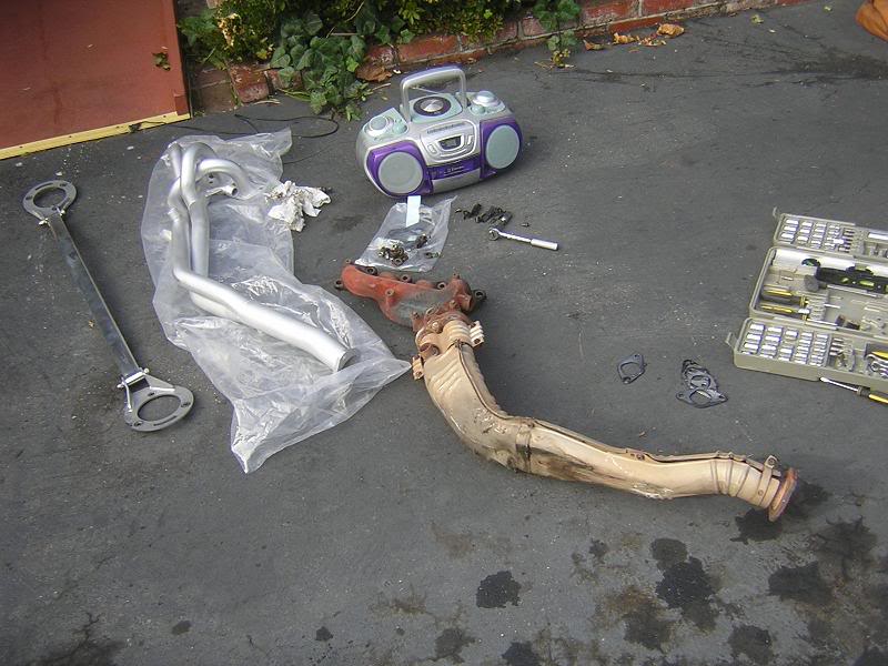

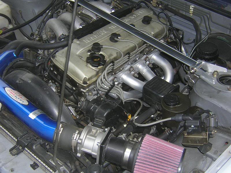

Huh, I think the DC is 4-1.
Your an idiot that doesn't SEARCH!!!!

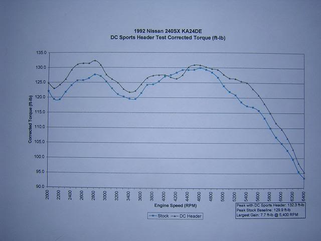

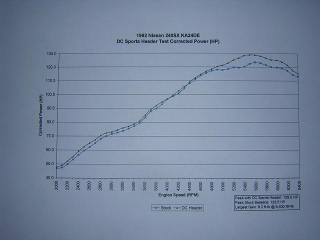

Are you shure about that HOT SHOT having the best results? I don't think so..
