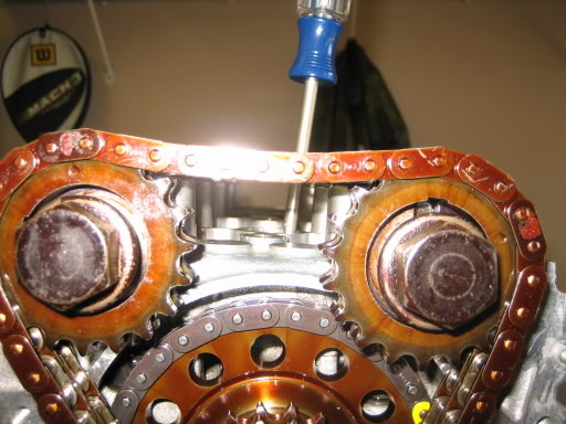

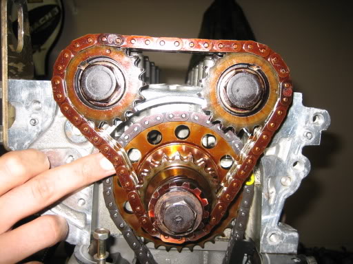

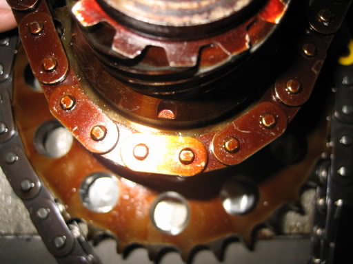

ok so im rebuilding my motor that i blew and were putting on the timing chain...so here a couple of pictures of it. would you plese tell me if this look right to you? i have all the marks lined up were i think they belong.

i looks fine to me, try rotating it to see if it skips.

Take a pic of the cams.

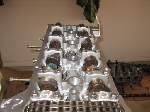

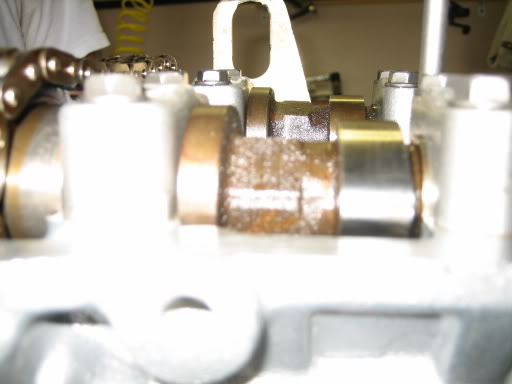

ok here are the pics of the cams...another questoin when i put them in does cylinder 1 and 4 pistons have to be at top dead center?
are these good? if not just tell me and ill get more of difrent angles...

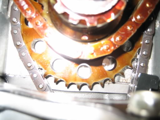

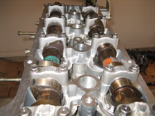

ok so i printed of a chart and we re did them tell me how does this look s13240? this is all done with piston 1 at tdc. the two cam sprokets look dead on. but the lower sproket where the chain connects to is off by one tooth, does that matter? if all the other things are on?

here are the cams...they are both facing the opposite directions but both straight out...

it looks right. i was reading up on ka timing alittle earlier and it said to have the cam lobes facing the opposite way and line up the marks on the the chain with the marks on the sproket.

we got it now thaks though! lol
