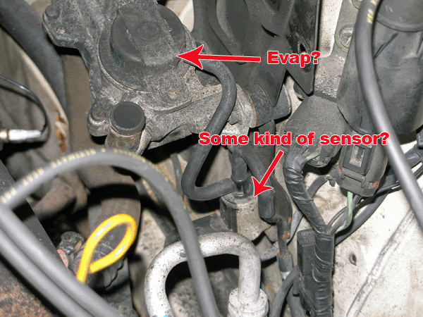

I have been having idling problems for a while and I noticed that my evap ( I think thats what its called) wasn't recylcing the air the way it should be. Instead of cleaning it, it is spitting out tiny chunks of what looks like carbon buildup through my intake. I can tell because of the large dark spot left on my air filter where the hose from the evap leads. I was planning on replacing this peace but it seems like it might be expensive. So I was wondering if I should attempt to bypass it instead.
Here is a picture of what I believe to be the problem.

if anyone could shine some light on this issue for me, I would highly appreciate it.

its the aiiv. allows cat to warm up faster by using vaccum to flow air one way. bad design cus when it gets dirty the reeds stay open. you can bypass it and plug up the holes, but it wont pass smog, well it might if the guy testing doesnt know what to look for. you could also take it apart and clean the reeds like i did. if you do, careful not to strip the screws. use plenty of wd40 and a vise grip to break em loose. gl
