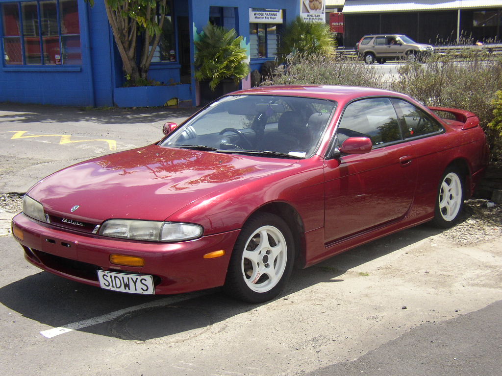

i have a s14 silvia sr20de non turbo i have a exaust system and air filter and im curious as to what would be the best options for my $$ to get some performance out of my sr20?

oh wow...rhd...badass...that car is pretty sick too...

yea there all like my one rhd i mean in new zealand

wow that car is amazing!

LOL good **** man , im asking what i can do to make mine(which is the burgandy s14 at the top of the page) faster and for the best options for my cash, cause quite frankly i aint loaded and i thought from reading your posts that you members are an on to it bunch that could quite easily help me out so yea,no ********* like that last dude who just wants a dream which he cant have like the s2000 and all he does is disrespect himself and all the other nissan lovers like myself
