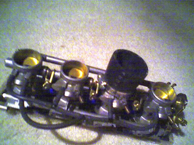

ok all you guys, i have a ka24det with jwt ecu, running @ 8psi and mid 200whp area! i love the turbo, love the power, but im an all motor freak! i dont like the powerband/power delivery, or the sound, and its my daily driver! so im taking off the turbo setup, for these and other reasons (weight reduction- my car is gutted to the max for a streetable car, and the turbo setup weighs like 100lbs at least.....handling should be noticably improved!)
so im going all motor......these gsxr 750/1000 itb's are going on as soon as i can affford the $ and time to build myself a fiberglass plenum for them. i am keeping my cobra maf and aac operational, so the car should idle and drive almost like stock!
here's a sneak preview from my phone camera for all you all motor guys to drool over.......just need to hack the manifold and figure out a bracket for the tps, already got the aac and vacuum all routed, working on the custom fiberglass plenum! (money's kinda tight right now so when i get some ill make the mold for the plenum and then i can make it.)

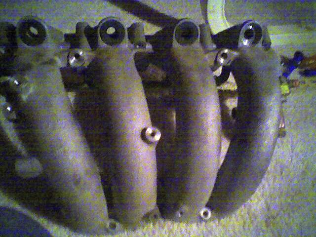

the stock manifold, to bed chopped in the middle

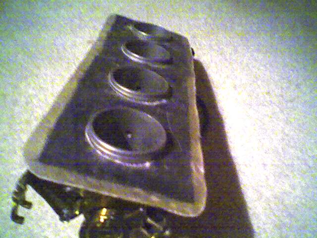

from the side......the plenum will mate up to this fiberglass plate, which will be sealed around the runners with silicone (ghetto gasket)

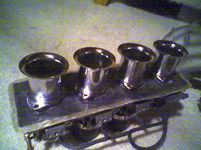

the gsxr1000/750 itb's by themselves, with secondary butterflys removed.

Nice. I assume this is for the KA. This will definitely help the KA breathe a lot better and help in throttle response. Can't wait to see the finished product and the outcome on the KA. One step closer to achieve power with the KA NA style. Haha, can't wait to here the ITBs screaming on the KA, makes you wanna change your pants already...
