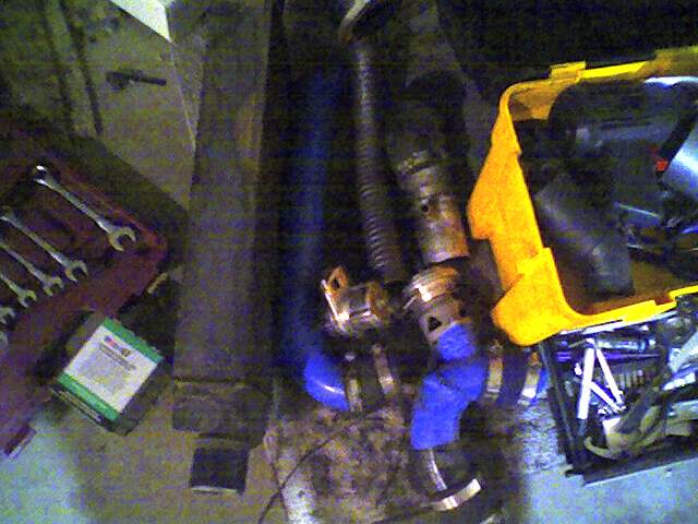

Old Sep 20, 2004 | 09:24 PM
sage's Avatar
Joined: Dec 2003
Posts: 109
the intercooler and piping and bov's.......now for sale......

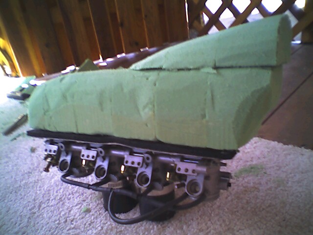

Old Sep 22, 2004 | 04:20 PM
sage's Avatar
Joined: Dec 2003
Posts: 109
UPDATE
well never try to make a mold out of cardboard and tape, it doesnt turn out pretty anyways finally got some money and thus construction materials for the mold and will be making the manifold in the next few days!

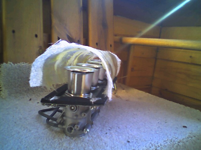

Old Sep 25, 2004 | 02:29 PM
  #29
sage's Avatar
Joined: Dec 2003
Posts: 109
Haha, I would donate to your cause, but no money to donate, lol! Good progress. Keep us updated.
teheh......yeah it sucks being a poor college student. and it doesnt help i just had to blow money on new tires, its getting into the rainy season and threadbare rear tires just dont work...hydroplaining everytime it rains isnt much fun.
here's the mold for the new manifold, in progress.
Attached Thumbnails Individual Throttle Bodie !project!-picture378_25sep04.jpg
