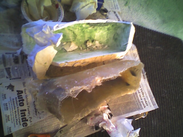

heres the plenum............. gotta finish the edges, sand and paint it. what color does everybody think? (i wish it were carbon but unfortunately its not, and fiberglass isnt exactly pretty ) im thinking either black or white...........

here's the mold and the plenum.

BLACK! white will make it look like a cheap toy. Black is powerful, stealthy, and scary

or if you want to be crazy, cream white. Then stencil a red japanese sunrise over the cream white.

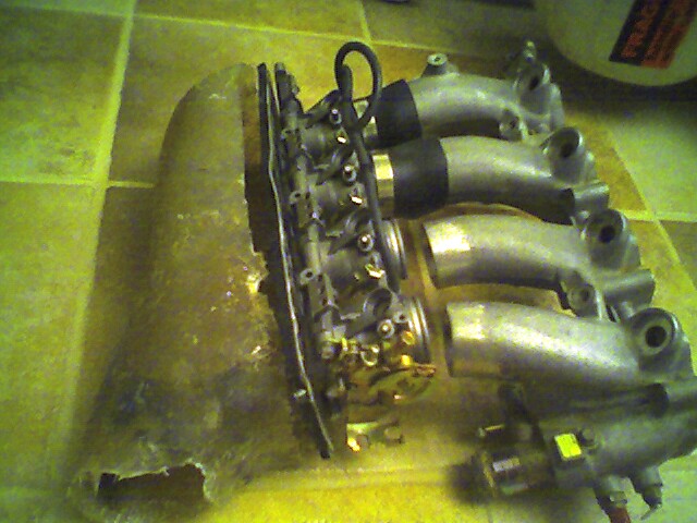

plenum and itb's and runners

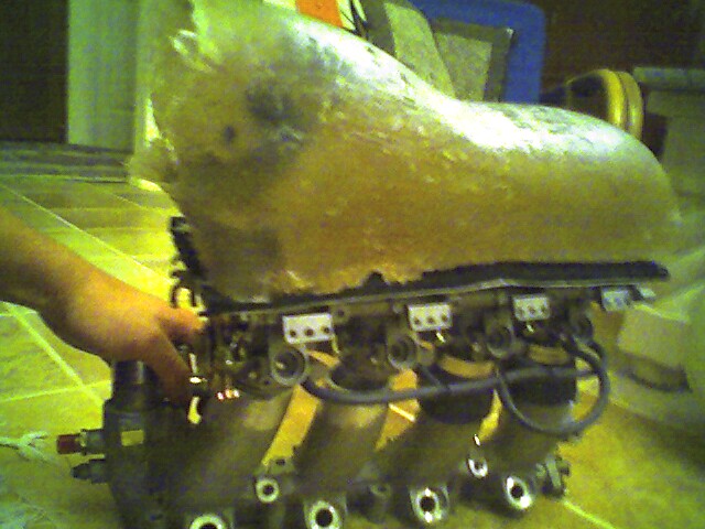

again

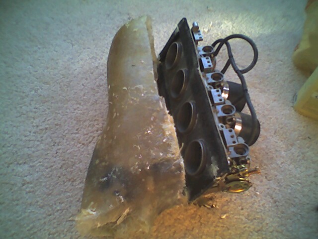

standing up

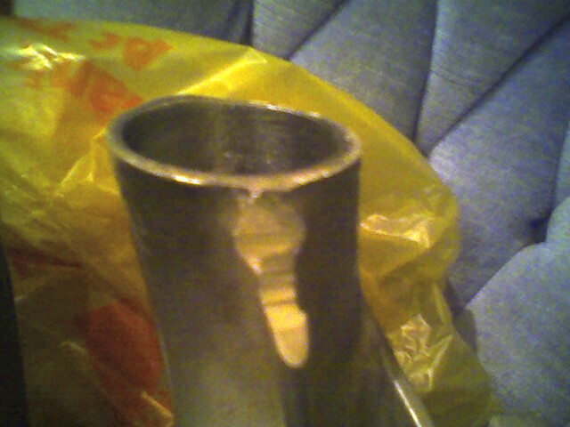

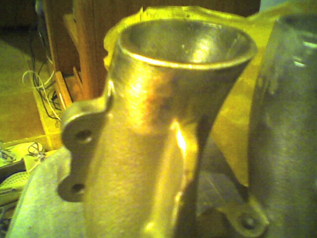

the bottom side of the runner which still needs grinding
Attached Thumbnails Individual Throttle Bodie !project!-picture396_27sep04.jpg

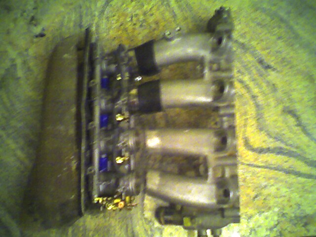

finished runner example
Attached Thumbnails Individual Throttle Bodie !project!-picture395_27sep04.jpg
